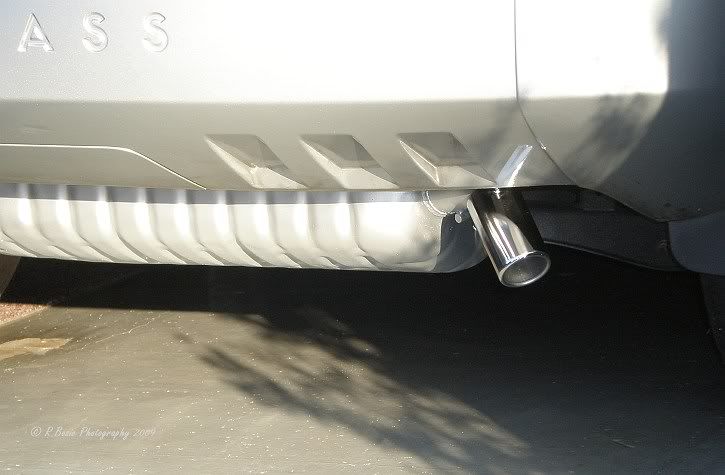

Now I think I can post a pic! I got this one at O'Rielly's today. It's nice and stubby and fits just right. I think it improves the looks. I wanted it in stainless but all they had was in chrome. I'll just have to polish it up every now and then.

I really like it. Who is the manufacturer. We don't have that parts store where I live. Do you have a part # or website that has the same one?

Sure do, it's made by ROLXtreme
www.rolxtreme.com
Part # 583021
I would imagine you could order from O'Reilly's website. List price is $8.99 but O'Reilly sells it for $4.99. There is one at AutoZone but it's longer and sticks out too far. It retails for 14.99 and is stainless but don't fit as well as the one from ROL.

Very nice................and clean !

Now that just looks sweet!!! Nice mod, and I think chrome looks better than stainless anyways IMO! Thanks for sharing the pic!

Yeah you right Cherokee, the stainless I tried at Auto Zone was actually sort of grey not bright silver like the chrome one. Only good thing about the stainless is it's stainless! no rust ever. I would presume the one I got today will rust out inside over time as it is only zinc coated on the inside with chrome on the outside. Oh well, $4.99 every couple of years ain't bad! If I find a shorter stainless one I will pass on the info.

Looks nice Skyeye, and who ever said wishes dont come true? I literally lol'ed when I saw that.

Hey Skyeye, how big is the diameter on that tip you put on the exhaust? I was thinking of getting a short tip but it's 6cm wide, doesn't look like that will get up around the curve of the existing exhaust like yours has.. Any idea of the width?
Another thing, I had my wheels rotated today and while the Compass was up there I had a look underneath.. My exhaust system seems to be brownish/rusted all along its length, is that normal? Is there something I should do to protect it/clean it?
Hey and when you painted the muffler did you take it off or just aim really carefully? Looks way better than the default "steel" colour!

1. the diameter is about 2.75 inches and it just makes the curve.
2. From what I can see, all the pipes show surface rust from the header to the muffler.
I painted that too! It stinks for a day or two until it burns in but is looks better and
I would imagine it cuts down on the rust. Jeep don't use stainless on most of their
exhaust systems to cut cost. Nonetheless, I feel that it would take many years for
the main pipe to rust a hole in it.
3. No need to dismount the tank. Just get a lot of newspaper and stuff it in and tape
where you don't want the paint to go.

Thanks Skyeye. Really helpful answer! I guess I'll need about a 7cm diameter, 6cm won't make it, and you have to get around most of the curve or it just looks dodgy...
Maybe I'll try some rustkill on the pipes and then think about painting them!

A word to the wise. The O'Rielly's chrome exhaust tip pictured on this thread has been on my car only since Jan 18 and already it is rusting on the interior surface. I had to paint it with the aluminum paint to try to stop the rust. I will be looking to upgrade to a stainless one even though it will cost 3X as much. Chrome don't hold up near heat and moisture. I thought I knew that. Sometimes the cheap way out is just that, the cheap way OUT!

Geez, that didn't last long at all man, sorry to hear that, sure looked good, too!

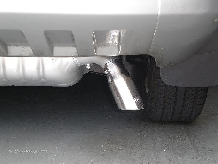

Just a word to the wise. Do not buy the "chrome" exhaust tips!! They are not going to hold up. My chrome one rusted out on the inside and was starting to corrode the factory tip. I changed it out for a solid stainless steel one which cost 3 times more but will not rust or cause corrosion.

Looking good...............way too clean..............too!

Hah! You can eat off my suspension!

That looks good, and now you know it's trouble free!

Well my fellow Cajun, I don't! I have thought it may stick out too much and get into scrapes on high curbs and driveways but so far it clears them with room to to spare. I was worried about corrosion due to "electrolysis" but I don' think it's a big issue. Two dissimilar metals tend to corrode but this will take some time and if I watch it I can keep it away by lubricating it from time to time with de-rusto or something like that.
