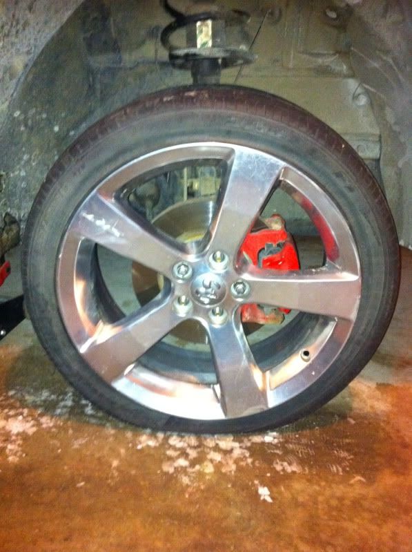

Just picked up a set of 19"x7.5" Caliber SRT4 rims. These need some TLC but i plan to paint them anyways. Gonna order some Hankook evo v12 tires, spacers, and new lugs. and have it ready for once the snow is gone. In the first pic they look really big sitting in front of my stock wheel but its an illusion. Stock overall diameter is 27.15", and these are 26.97". Also im not gonna use the Ram head center cap im gonna use the jeep center cap and make it look legit.

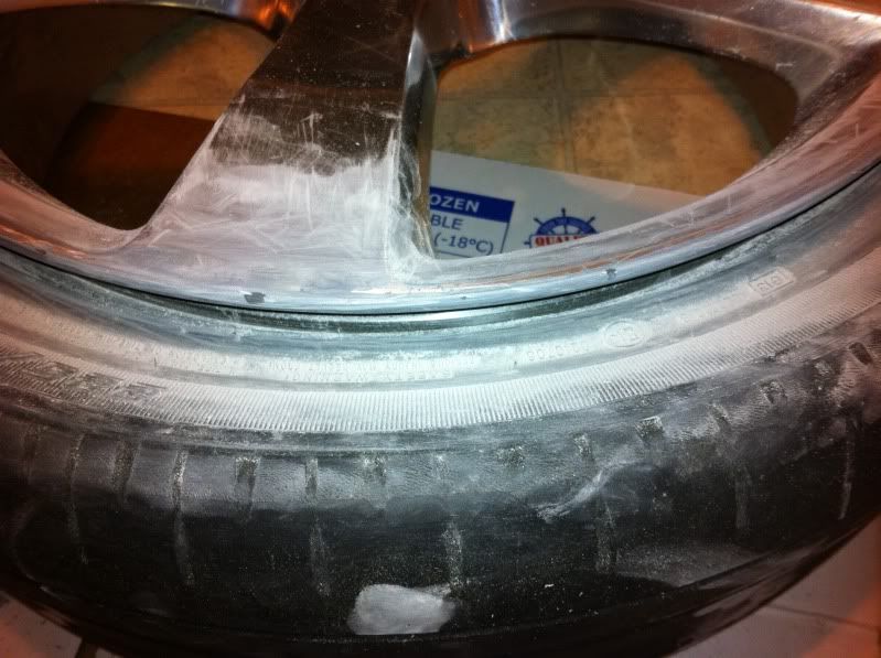

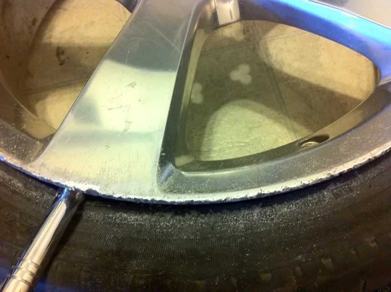

thx im gonna finish repairing them tomorrow night then paint them some time after christmas. 1 rim had a 7" section of curb damage
2 had minor curb damage, and 1 was fine. I found this great guide on a ford focus forum.
http://www.focusfanatics.com/forum/s...d.php?t=112771
Useing JB Weld to rebuild the damaged section then taking it down with a metal file and sand paper. the end result turns out great ill post pics once the repair is complete
post #4 of 15 Old 12-20-2010, 09:34 PM Thread Starter

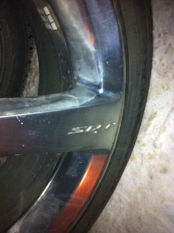

the 2 dark spots needs a jab of jb weld to raise them, another sanding and the repair will be complete
post #5 of 15 Old 12-21-2010, 04:09 PM
Nice work so far, thanks for the progress pic!

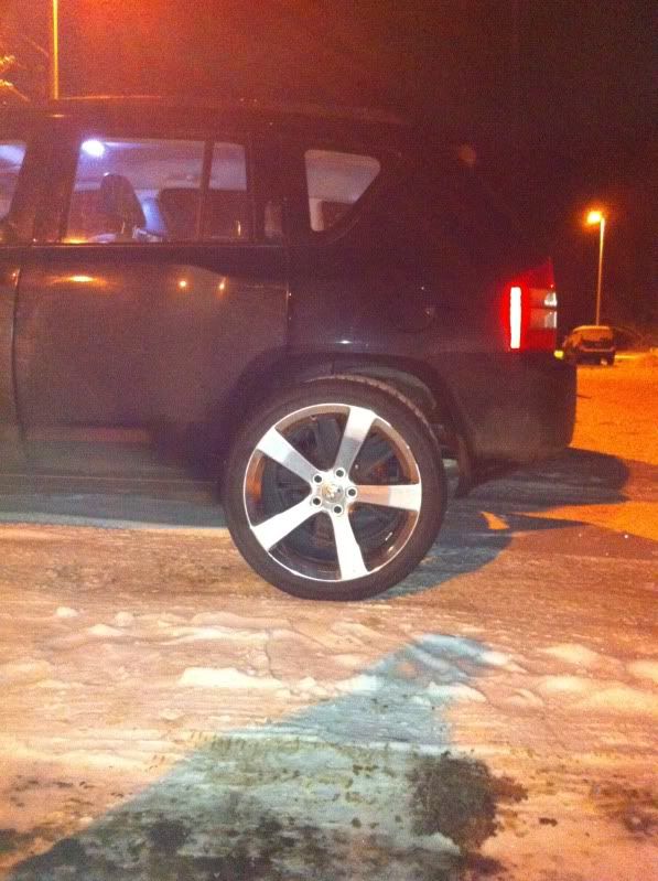

Test fitting the 19's, i will need about a 1 inch spacer to keep a good space between the tire and strut once the 245's are mounted on the rims.
picked up all my paint and materials, got the tires dismounted, and started painting the rims earlier today. Pictures will follow upon completion

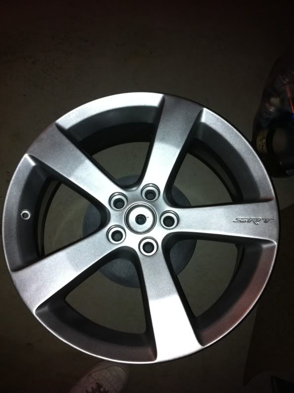

Finished!
post #14 of 15 Old 02-14-2011, 10:22 PM
wow............another great job..........Sheck......can't wait to see them on.........in spring that is !!!!!
post #15 of 15 Old 02-18-2011, 12:26 PM
Beautiful work Shecky, I definitely look forward to seeing those installed!!!
