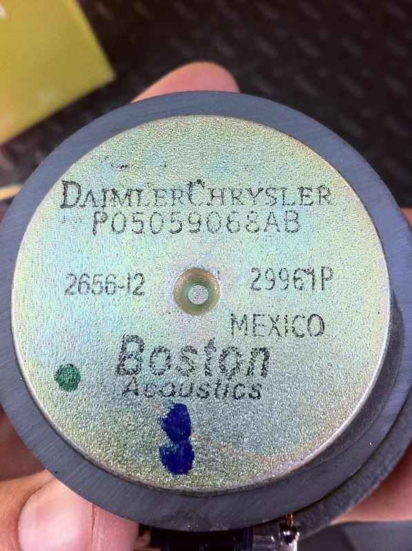

2.5" Boston from dash

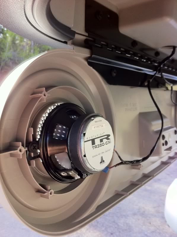

3.5" Boston from hatch

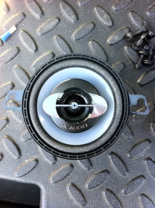

New JL 3.5 2-way
the back section of this is held on by 8 screws

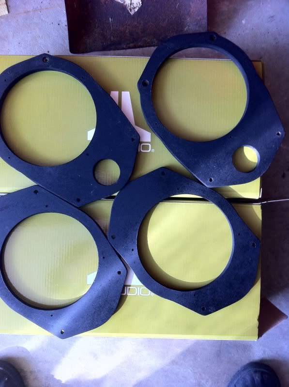

tuesday i am getting my adapter plates made to go from 6x9 to 6.5 made at my local audio shop, install will happen wed more pics to follow

Adapter plates

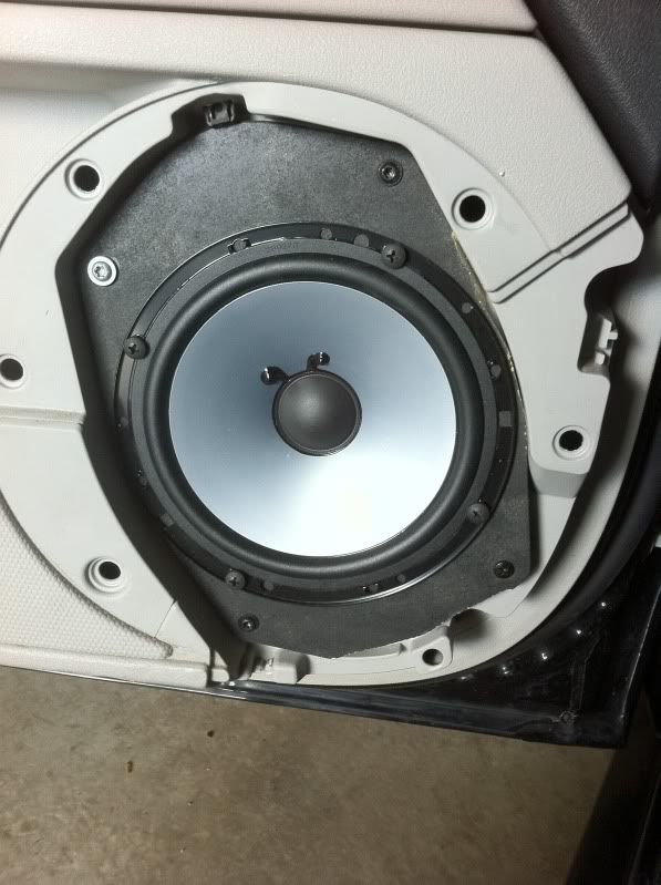

Front speaker
Rear speaker

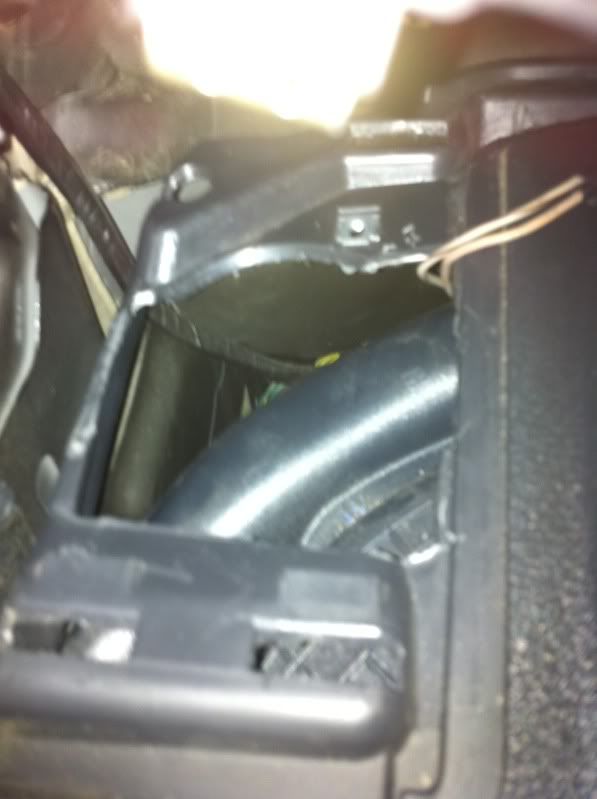

i have plans for an 8" box that fits in where the cubby hole is you would have to fabricate a cover for the hole. then mount the amp somewhere under the rear deck.

Hmmm, I guess I have never really taken a look at the higher end Compass'. Is that the original location for the factory sub?

yup that is the location for the factory sub, the patriot and the compass are based on the same platform so there is alot of stuff that is the same in the two vehicles.

The guy who made that thread from the patriot forum had the normal sound system. Looks like he popped out the rivets that hold the cubby hole.

i wasnt very happy with the 1" tweeter in the dash, the lows and highs had too much distance between them. So like any good installer i cut the holes bigger and stuffed in my set of 3.5" JL 2-way speakers. I am very happy with the sound of everything now. i used a utility knife, but a dremel tool would be alot easier.
