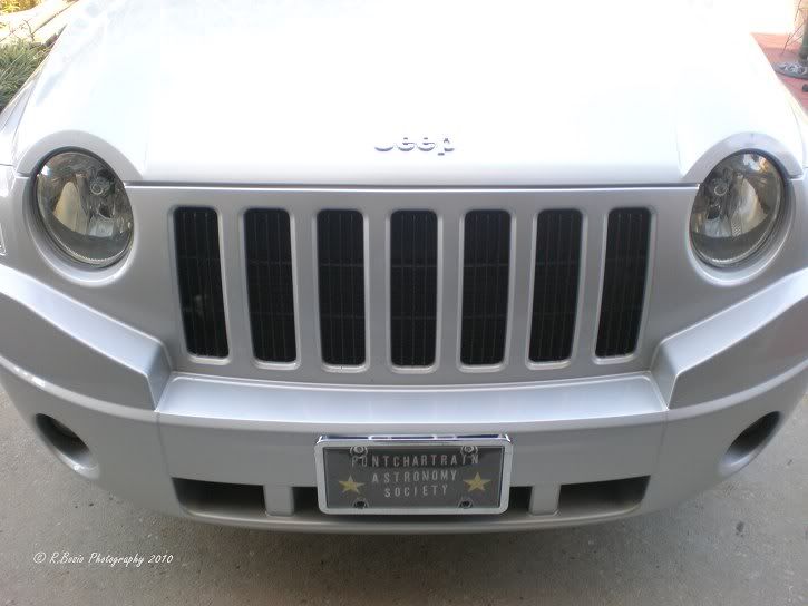

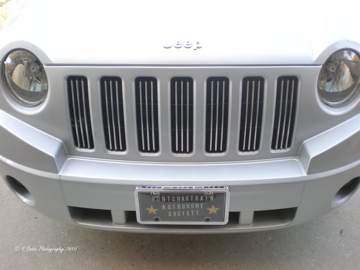

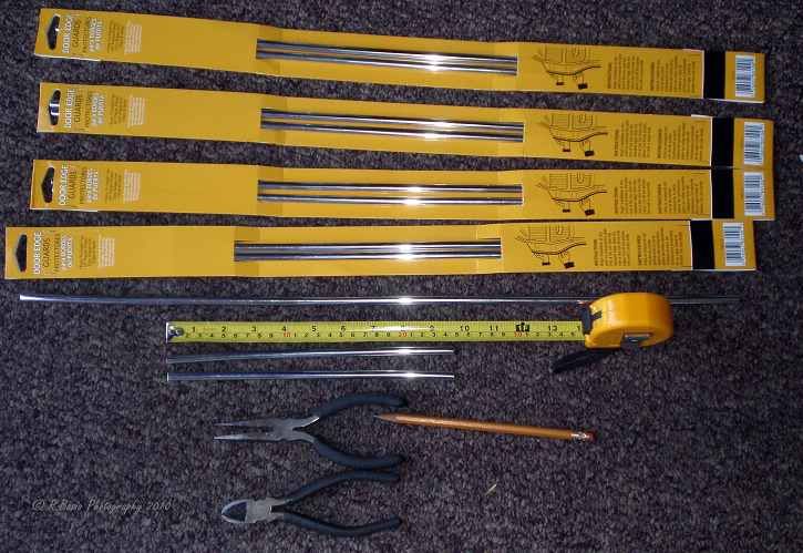

OK, here's the skinny on installing "Unkle Rem's Grille Mod"!
When you get the door moulding make sure you get all the same model #. Then you will need a few tools and about an hours time. I re-measured the length of the stock grille vanes and came up with 9-5/8". You can eye it up yourself and use your own discretion as to length. The total cost of this mod (if you use the Wal-Mart door edge) came to $16.79.
Here's the images:
#1-Before URGM
#2-Necessary Tools
#3-Push on (hint: let it sit in the Sun a while to warm the grill and moulding)
#4-After URGM.
