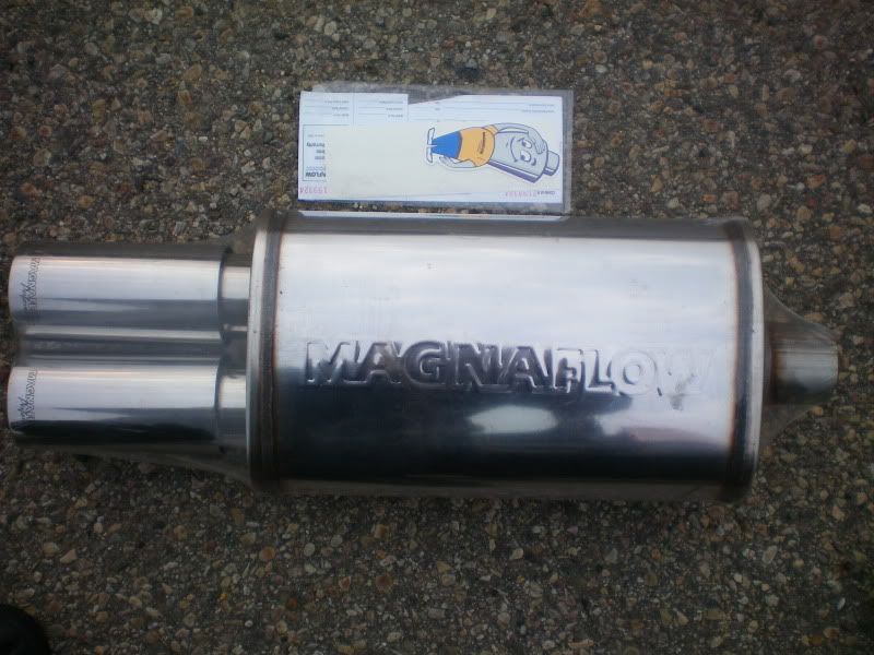

whats the forums thoughts of the center exit exhaust like on the srt8, and my next question can anyone picture something similar to this on a Compass? im not sure if i like the look of the magnaflow cat back kit for the compass so i thought id toy around with something custom, then as a fail safe i could always just buy the magnaflow kit if my creation wasnt as i imagined it.
we've been throwing this idea around at work for the past few days, we've worked out the kinks and i think it would look really cool! im leaning towards a universal magnaflow muffler and keeping the stock pipe, but we have to modify one section of the factory pipe to bring it to center.
also there is a section of the rear bumper i would be removing, but saving so i can reinstall if needed.
the end result i want the muffler close to the heatsheild, i dont want it hanging down low so the whole muffler is seen. and its gonna be sunk back so the tips are not sticking out further than the flat part of the rear bumper. i know i wont be able to install a hitch with this setup and im ok with that. the compass is too weak to pull my trailer queen import. so i put together this long ass post to bounce around this idea and get feedback. thx in advance guys

as with all the projects on ye old jeep i will be taking photos of the whole project and posting. were gonna take the exhaust off from the catback and install our custom bent pipe and weld the muffler while its off. then paint the exhaust with the high heat flat black paint used on my oem muffler so it looks pro. cause new pipe with the old pipe wont look too sexy lol.
also i gotta find some trim or molding to put around the cut out section of the rear bumper.

post #11 of 58 Old 08-01-2010, 12:20 PM Thread Starter
its got dual 3 inch tips on the muffler
http://www.magnaflow.com/02product/s...e=main&id=8681

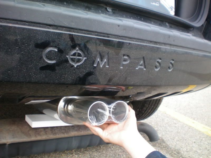

update on the center exit setup. did some more measuring and sadly i dont think the bumper will need the cutout. as the angle of the lower section of the rear bumper probably wont interfere with the tips. i was kinda looking forward to the tips being tight into the cutout section. going to order my muffler on friday
post #22 of 58 Old 08-04-2010, 12:02 PM
You can always bend the hooks to make the muffler hang higher (slightly) and then cut out the bumper as needed...
post #23 of 58 Old 08-04-2010, 12:38 PM Thread Starter
from how it looks the new muffler would have to be pushed up against the compass for the tips to be where i want them, and thats not a good idea. were not useing the factory muffler mounting points, instead going off the rear cross member with a fabricated hanger setup. its too bad our bumpers angle in at the bottem that foils my sunken tip look haha. ill know for sure when we remove the stock exhaust then i can mock up my magnaflow muffler
post #24 of 58 Old 08-05-2010, 03:07 AM

today i went to my muffler shop, pulled the compass in and got in the pit with the muffler man told him what i wanted . and he custom bent up some pipe for me, i also picked up the clamps and hangers for mounting the new setup. after that went to the parts shop and ordered the new magnaflow muffler and it should be here tuesday. so the ball is rolling again .

i got the muffler on wednsday, later that night we dropped the stock exhaust and mocked up the new muffler. i was really happy with the fitment and i have to admit i think its gonna look really good. also i will need to do the bumper cutout so that will look badass. total cost so far has been about 240 for all the parts includeing the muffler . my welder is gone for holidays so it will probably be about 2 weeks till we get the time to do the install. maybe tomorrow ill snap some teaser pics

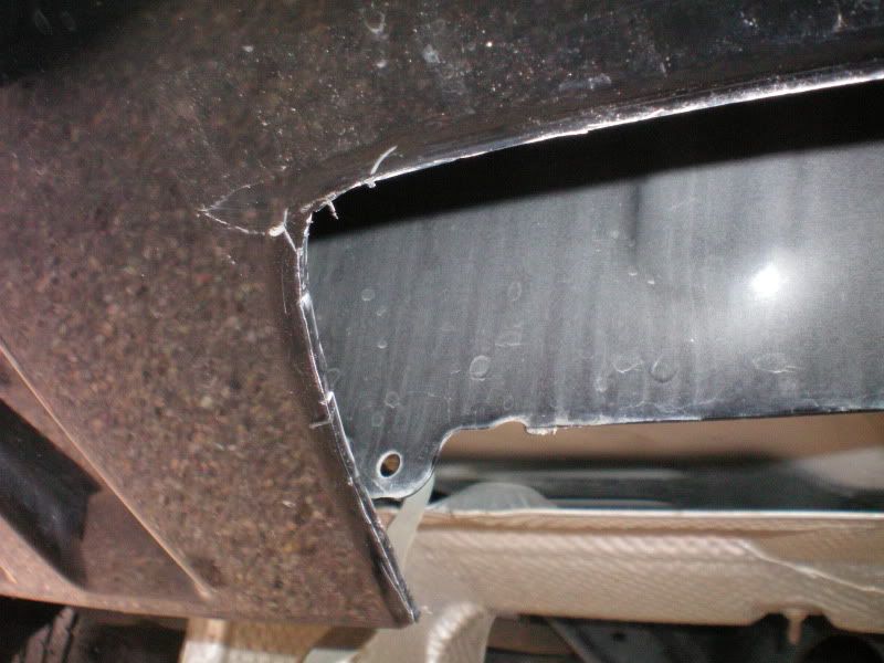

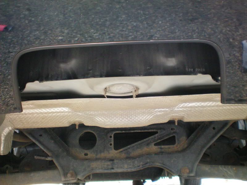

post #29 of 58 Old 08-21-2010, 04:27 PM Thread Starter
Update with pics,
today i cut out the bumper section
then i cleaned up the cut and installed the trim
(before i cleaned the cut)
(finished product! )
and here is some pics of the muffler and a teaser with the stock exhaust dropped
post #30 of 58 Old 08-22-2010, 05:53 AM
SAWEEEEEEET!!!!! That is going to look awesome, nice work on the cutout, "finished product" looks professional! I am really hoping for a vid clip so we can hear that exhaust!
