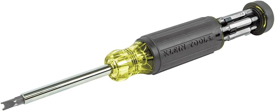

The best tool would probably be something like a security screw driver (like this https://images-na.ssl-images-amazon.com/images/I/51uwPmKUmNL._AC_SL1000_.jpg), but an Allen key will work just fine. What you need to do is insert a tool into one side and push on the spring/wire pushing toward the center of the wheel. This will release the clip on the airbag post. See new video below. Might need to click if it doesn't auto play. For the bottom, same principal, but you need to push up towards center of the wheel.
