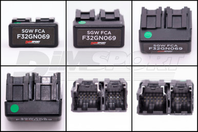

I have the obdlink mx bluetooth and trying to modifiy the parameters in the BCM. I physically located that SGW, it is installed above the pedals behind the steering wheel accessories.
Due to SGW, any change was not possible. I ordered the Autel 8+12 cable, waiting it to arrive.
Moreover, AlfaOBD android APK has recently been updated to check the connection with Security Gateway to whom are not sure for their 2018 Compass etc.

Okay, I got all of my supplies in. Has anyone installed the "double bypass cable" that AlphaOBD says is necessary to get around 2018+ security updates? I bought the double bypass, and the instructions are for a Dodge Charger with a trunk mounted battery, I think. I've also got all of the colorful cables and two different OBD2 modules. And AlphaOBD software for PC.

Honestly, the 12+8 bypass cable feels like it would cause less potential problems down the road and is dead simple to install. On the 2020 all I did was lay on the driverside floor, and looking straight up into the footwell you can see the module/plugs plain as day. The first time I popped it in it took maybe 2-3 mins, now it's a 30 second process.
With that said, tapping into any one of the various star connectors is a tried and true method that is applicable to most FCA cars. Not to mention it's far more discreet than having a 12+8 cable hanging down.
