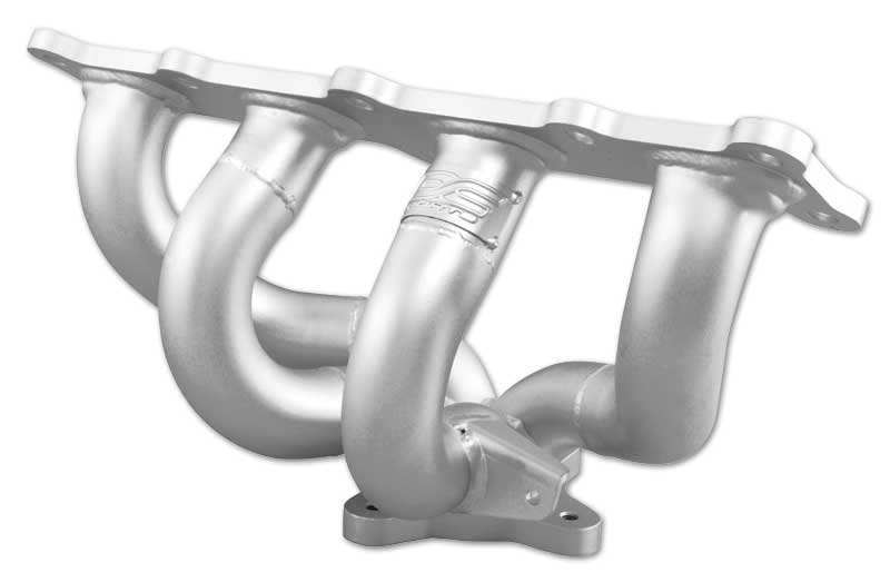

And heres a picture of the DC header for the Caliber
http://www.howellautomotive.com/ProductImages/DHC7612.jpg
Heres a picture of the Mopar Header
http://www.leeparts.com/graphics/CalHeader2_hc.jpg

No I sure don`t Realtune was the one telling me it will fit the 4X2 it is a DC sport header made for the caliber I think.
