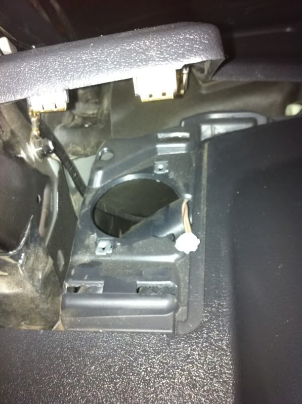

Remove the A-pillar with the 1 screw that holds it, then gently lift up the grill over the tweeter. it is held in by clips.

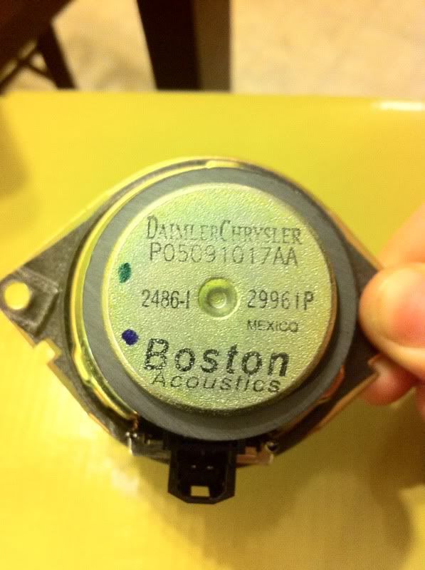

2.5" Boston from dash

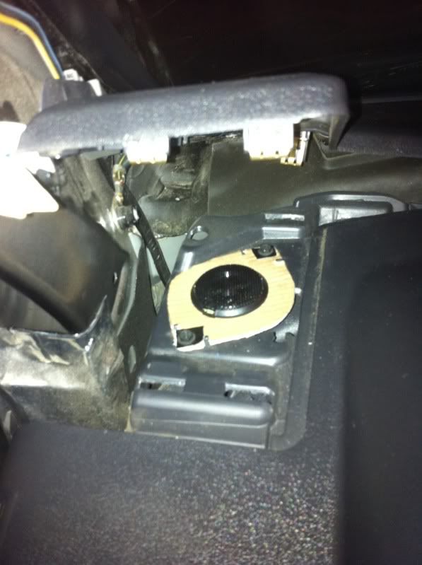

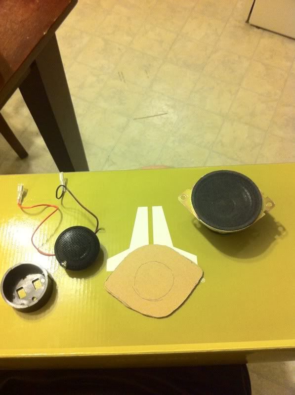

fabricated an adapter bracket
tweeters done
