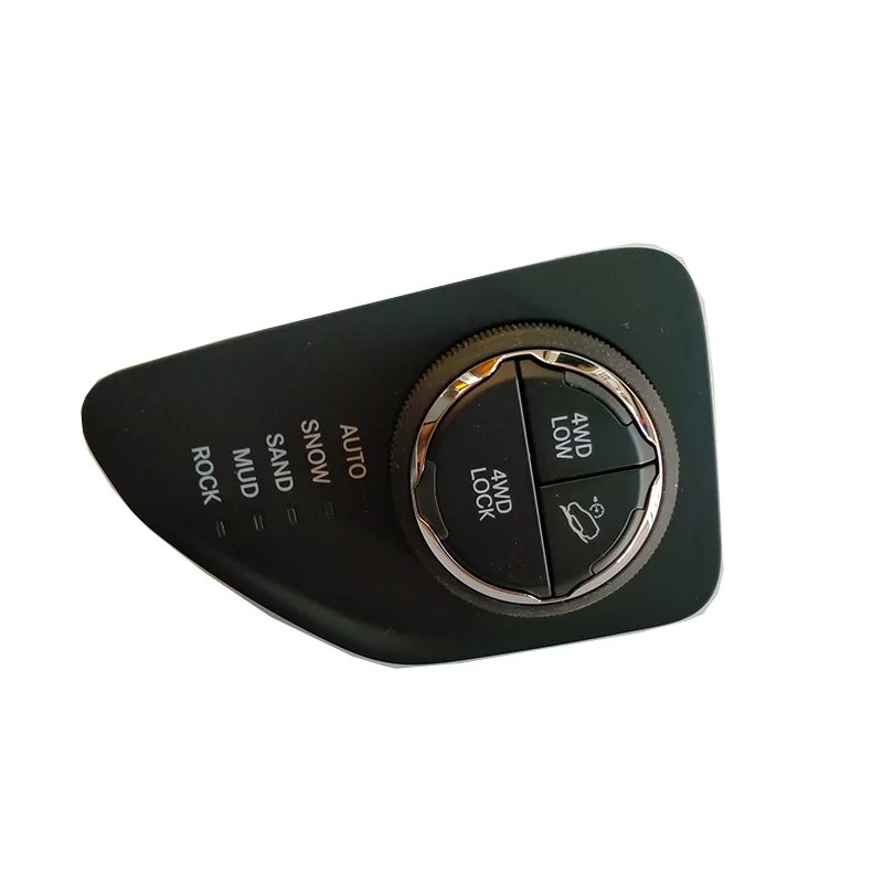

So I succesfully installed 4wd low, Rock mode and Hill Descent Control (HDC) on my 2018 jeep compass 4x4 limited.
Requirements:
  • New Transfer Case Switch 5XF15LXHAA or 5XF15LXHAB (I got mine on aliexpress for 38$ and it works fine)
  • 9 speed automatic transmission
  • AlfaOBD and adapter cables (I use an OBDLink EX and an extra "grey" adapter to complete proxy alignment)
  • Axle ratio of 4334 (You can check your axle ratio with AlfaOBD in the Body Computer in the status/faults tab and click on "system status" next view log and search for Axle ratio)
Some jeeps have axle ratios of 3734 or something different. This mod might also work but they will have a slightly lower final drive ratio than the real trailhawk. Some people say this is problematic and some say it doesn't matter all that much. If you have something different, use at your own risk. I had 4334 (same as trailhawk) so nothing to worry about.
Installing the switch:
  • Use a plastic prying tool or credit card to undo the clips of the shiny black frame (I started at the top right corner and worked my way down and then to the other side)
  • Put the shifter in neutral so you can lift the shiny black plastic a little more to access the metal clips holding the Transfer Case Switch in place.
  • Undo the 2 left metal clips first and then the bottom one, it should come out after that with some wiggling.
  • Disconnect it and put the new one in and just push everyting back into place.
AlfaOBD:
  • Select Body Computer Delphi/Marelli and connect
  • Go to Active Diagnostic tab
  • Choose Car Configuration Change
  • Find Terrain selector modes and set it to 5 modes
  • Find 4 Wheel Drive Low Button and set it to present
  • Find Hill descent control and set it to present
  • After that go to PROXY alignment and run it
  • Turn car off and let it sit for a few minutes
Now you have succesfully installed 4wd low, Rock mode and Hill Descent Control in your non trailhawk jeep compass.
which one you installed 5XF15LXHAA or 5XF15LXHAB ?
I installed a chinese one which was listed with 3 product numbers. I don't know what the difference is but I think they will all fit until the 2021 model.
If you want to be sure buy the mopar one but it's around 120$. For me the price difference is a bit too much to justify buying the mopar one.
ok, checked and i have same Axle ratio 4334. Found some used one 5XF15LXHAB ~60$
@Laurens what about "4wd low", is it working?
It seems to be working. When I push 4wd low, it turns FCW and ESC off so it definitely does something.
When I go to rock, it is locked in second gear and you can't change it.
However I expected it to lock in first gear in rock mode because that is what you read everywhere. I made a new thread to ask trailhawk owners about this behaviour because nobody seems to know what 4wd low exactly does.
I can get it to lock in first gear by going to mud mode and putting the shifter to manual shifting (mud starts in first gear) and then change to rock mode with the shifter still in manual.
When I do it like this it is locked in first gear and putting it back to automatic shifting still keeps it in first gear.

ok, it works ;)
I've bought used one 5XF15LXHAB from Grand Cherokee
